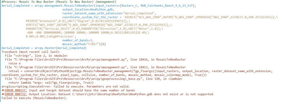

MahaTannous
Now this.. Not sure why is says the database does not exist or isn't supported.
Arcpy.Exists("NewPython.gdb) = True
DanPatterson
MVP Esteemed Contributor
specify the full path to the NewPython.gdb as it appears that you did, but you have other issues
You need to create the gdb, but preferably specify a folder as the output and make Aerial_Completed.tif a tif file in that folder instead.
If there aren't 3 bands in the raster, then don't specify 3 bands
btw
is an assignment statement not a test of whether it exists so this isn't very useful
... sort of retired...

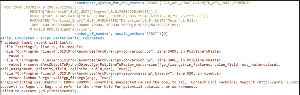

MahaTannous
Dan,
I'm still working on clipping the parcels with the buffer lines contained from that initial project. One option I was given was to save the buffer lines from Polygon to Polyline, then polyline to raster, then combine the polyline raster with the original .tif file (the aerial shot) which has four bands.
I went back and ran the composite bands four times so I can get equal number of bands, then realized the pixel type was different on each raster. Then the pixel type was different, so I changed that to match.
Basically merging two rasters on top of each other to clip into parcels. Sorry for the long-winded story.
Here's the most recent error message..
DanPatterson
I am not sure.  Are you making *.tif files in a folder?  And I am not sure that 4 bands can be created since one of the bands is transparency.
