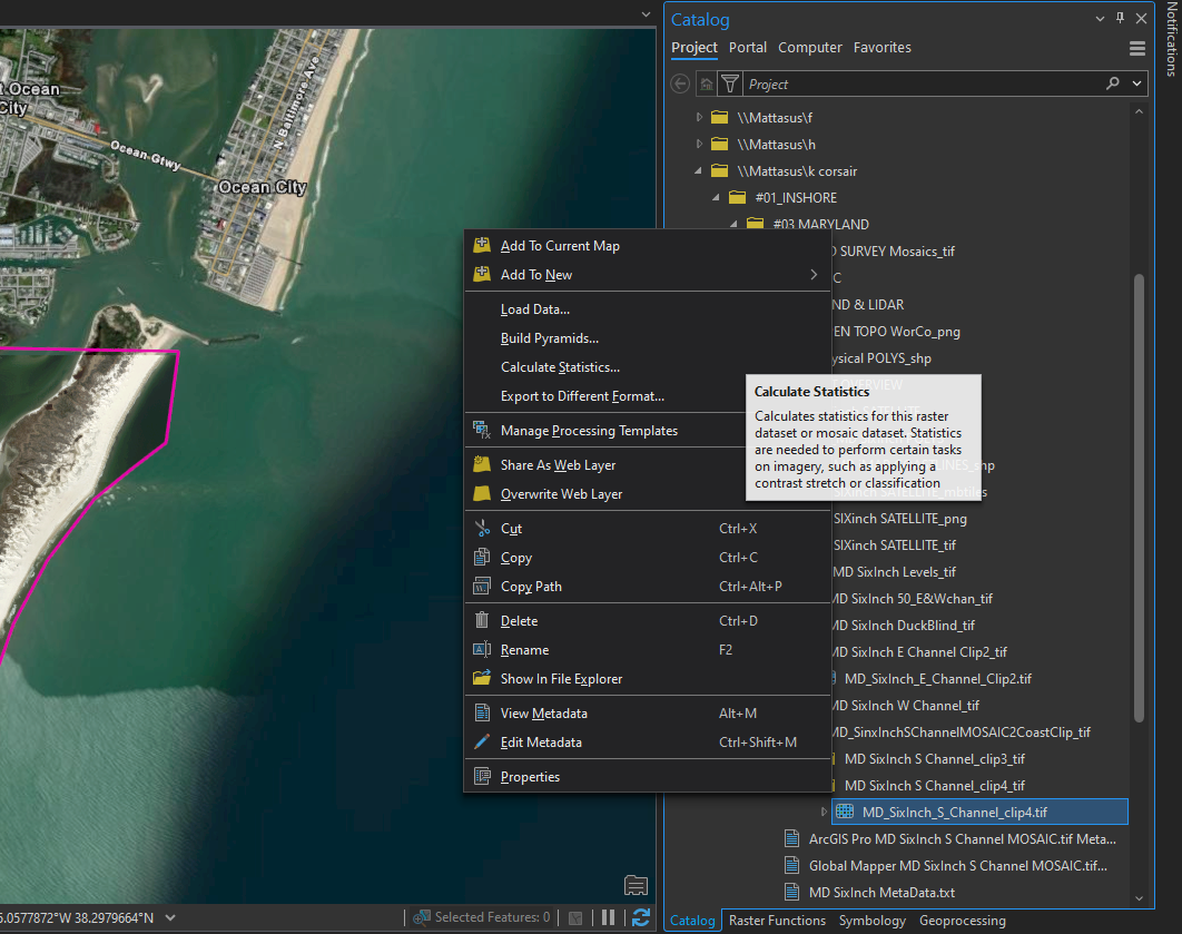

  3. RMB on GeoTIFF -> select Calculation Statistics from the RMB menu -> let the tool run so the raster GeoTIFF displays in the ArcGIS Pro Contents pane.
  4. I start from the ArcGIS Pro -> Catalog folder directory to load the images. I browse to the folder where the images are stored, select an image -> RMB, then select ‘Calculate Statistics from the menu.

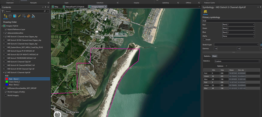

5. After Calculate Statistics is done, the GeoTIFF appears in the Contents file directory. I expand the file and select one of the RGB bands to open the Primary Symbology form. (Note that Symbology has the system-generated statistics populated).

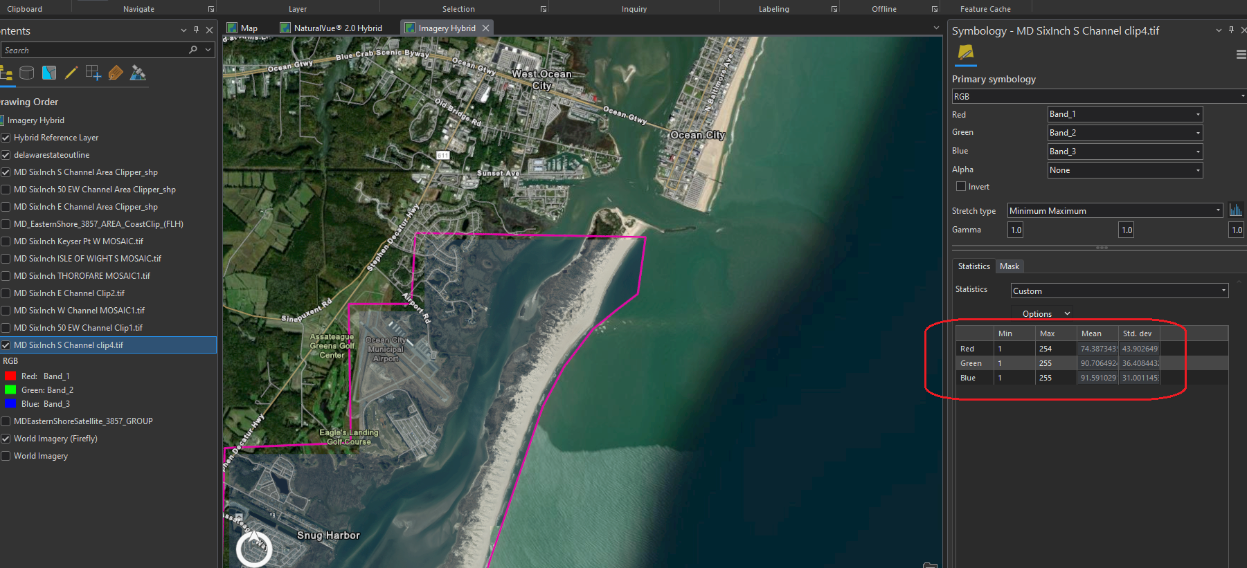

6. I change the Statistics from Dataset to Custom then enter the custom statistics values that should be common across all images.

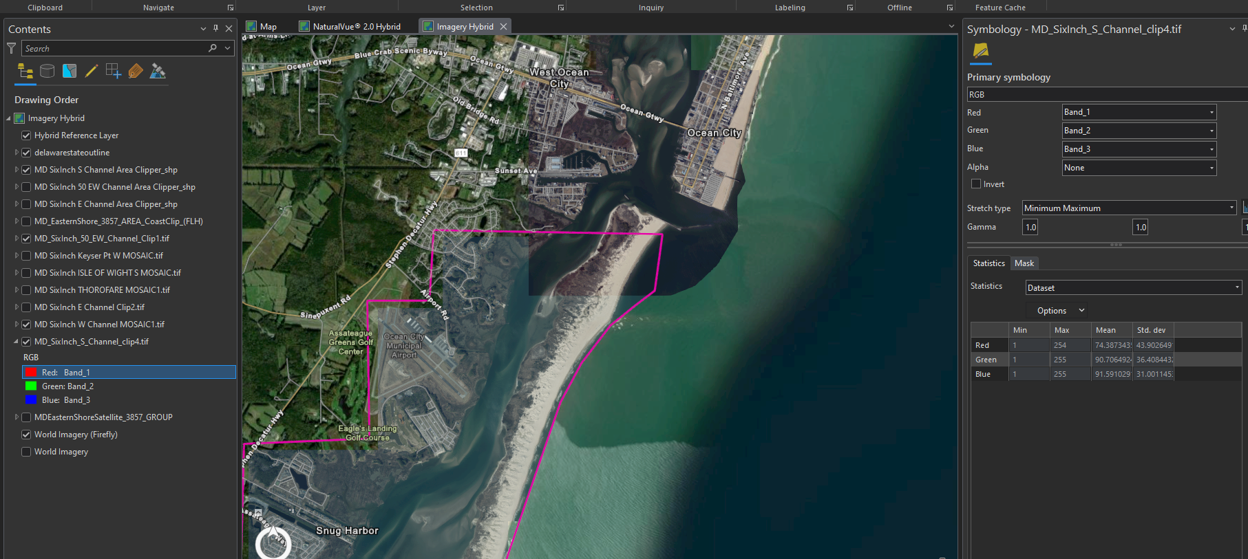

7. Everything looks good at this point, but if I take the focus off this file, then place focus back on the file, the Minimum/Maximum Stretch Type has been deleted, and the RGB bands with the custom statistics populated have been duplicated so there's 6 bands instead of 3.

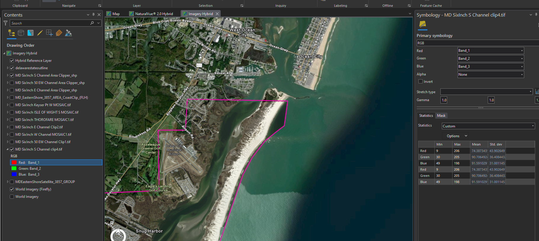

8. If I repopulate the Stretch Type field with Minimum/Maximum, the custom statistics are replaced by the system-generated statistics.
