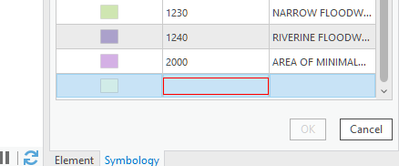

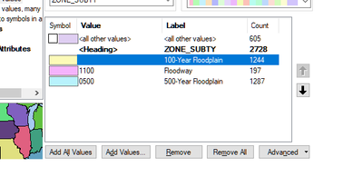

I need to symbolize features by a certain field where Null / No Value is a legitimate value that needs to be symbolized.  I do not seem to be able to do this in Pro 3.1.1 or ArcGISOnline, though it was easily done in ArcMap.

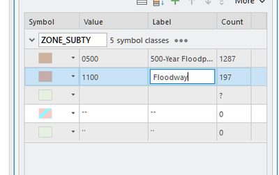

I've tried to Add Values and then in Options, Add New Value.  I can't find anything to enter as a value that will symbolize the features.  I've tried leaving it blank, "", '', <Null>, etc.  Features don't show and count is either 0 or ?.
In Pro:

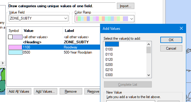

This was simple in ArcMap:
What am I doing wrong?  Or is this one of those things that hasn't translated from Desktop to Pro yet?

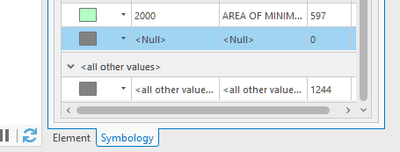

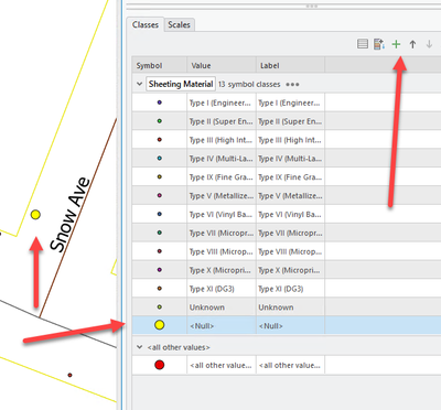

RhettZufelt
MVP Notable Contributor

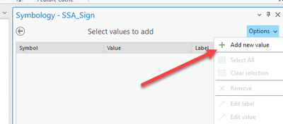

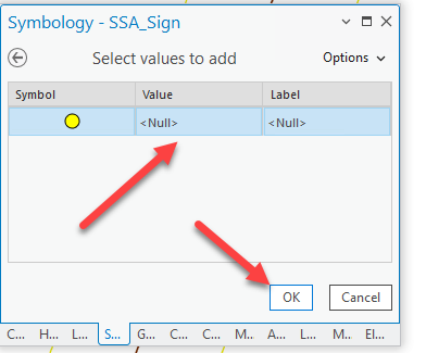

I then click the green + sign, then Add new value:
Select symbol and type <Null> in value field and click OK:
Adds new symbol for Nulls:
R_

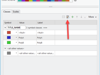

I actually copied the <Null> from the table, but just tested by typing and working fine.
Also, noticed that you are using polygon data, so just tested with poly data and it automatically detects the <Null>'s in the symbology field and adds it when I hit the add all values button.  Just re-tested with points, and if I hit the add all values button, and I have actual <Null> values in the symbology field, it will add them automatically as well.
However, if I remove it, it still lets me type in the value and add it.
Are you sure there are actual <Null> values in the field?  (Not blank, space, or text 'Null')
R_
edit:  Tested in Pro 3.2.1, 3.1.3, and 2.9.3 all with same results.  Using FGDB polygon feature class

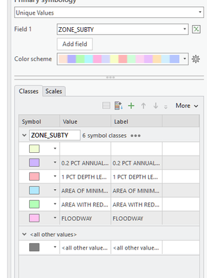

I am not sure exactly what the values are in the field but they are truly blank - no space, no text Null, etc - otherwise these would show up when I hit the add all values button.  When I open the table, <Null> does not appear.
When I try to add all values, "Blank" does not show up in the list, but those features are seen and grouped into "all other values".  I've tried to manually enter a blank / empty value and Pro will not recognize it - it can't even produce a count of 0.  I've also tried to add "", '', space, Null, <Null>, etc etc etc and nothing seems to work for these blank values.
ArcMap does recognize blank / no value as a legitimate value, however.
