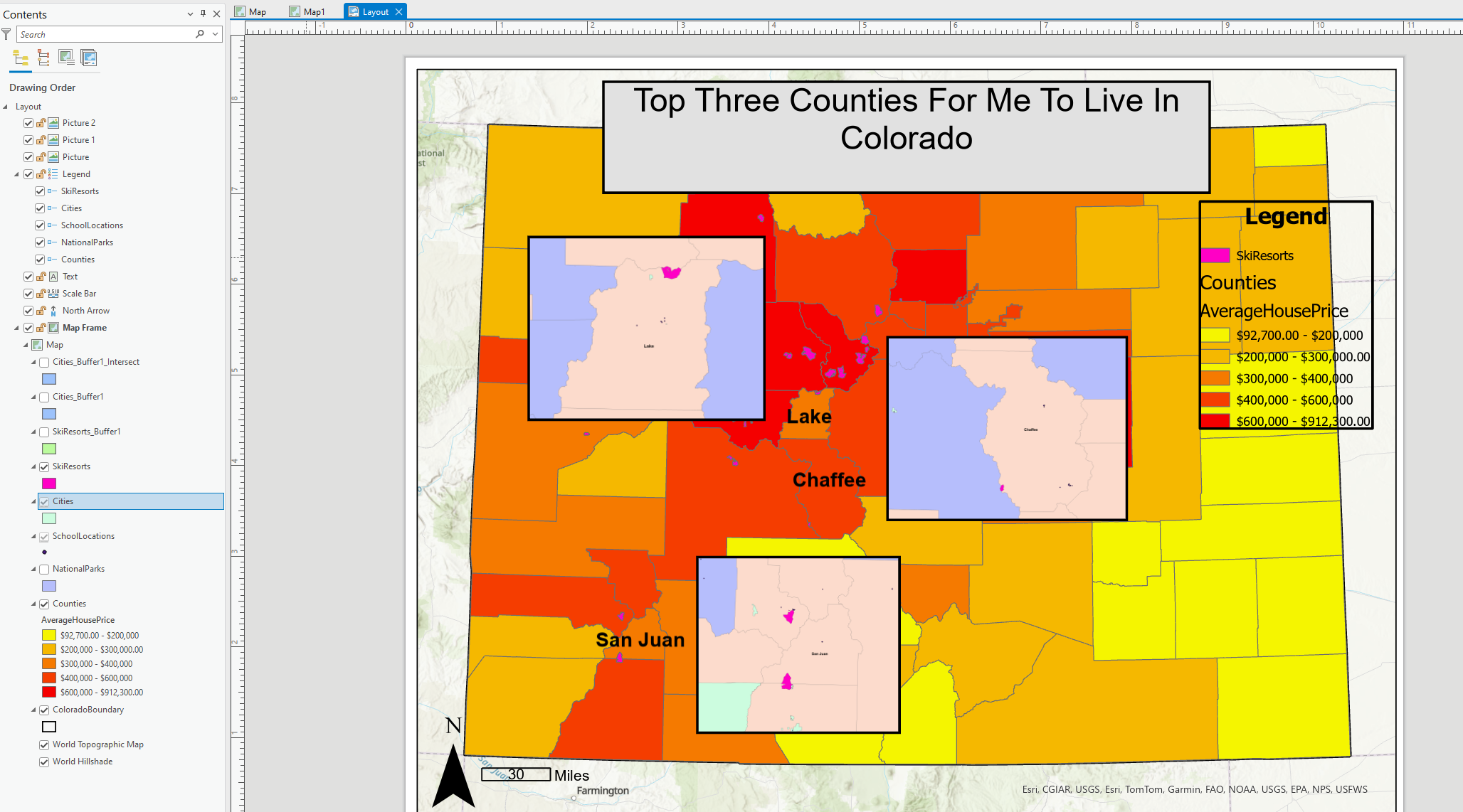

So I'm trying to complete my project for school. I need my legend to display all my layers on it however it's not. I think it is because I have some layers set to only be visible within a certain zoom. These layers are visible on my inset maps but not on the main map so it's not displaying on my legend. If anyone could please help me that would be greatly appreciated!!Capture.PNG

In the Format Legend pane, under Synchronize with Map, Layer Visibility should not be checked. Then you should be able to add all layers to the Legend in the Contents pane.
