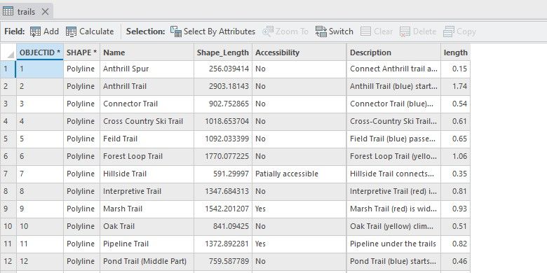

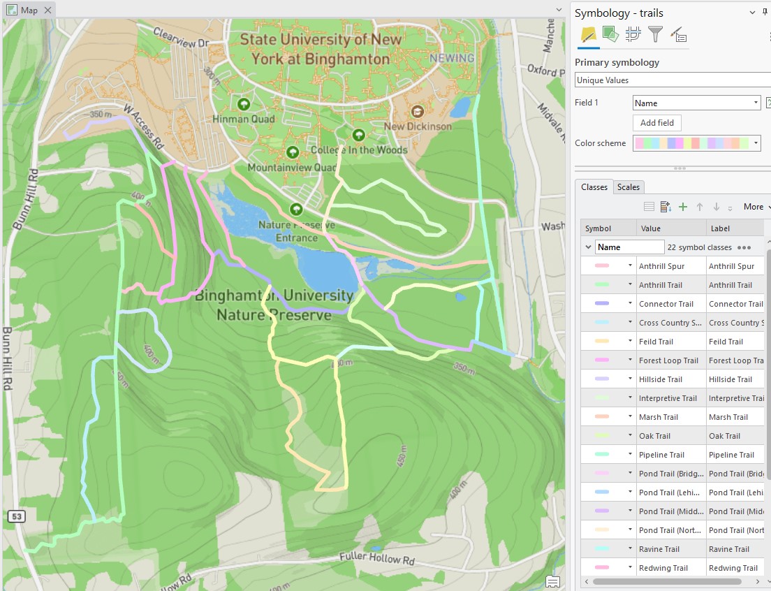

I am wondering if ArcGIS pro symbology can classify two fields using unique values.
Screenshot 2023-10-22 223459.jpgScreenshot 2023-10-22 223459.jpgScreenshot 2023-10-22 223430.jpgScreenshot 2023-10-22 223430.jpg
For example, I want to using 2 pt dashed -line symbol to represent the trails is not accessible for people with disabilities and 2 pt width line to represent the trails is fully accessible. At the same time, I want to use different color to represent different trails' name.
Is there any convenient way to achieve these goals rather than do it manually?
Any help or clues would be great appreciated

In the Unique Values symbology pane below your Field 1 value, there's an "Add Field".  Field 2 could be your accessibility field. ArcGIS Pro will then do unique value symbology based upon Name and Accessiblity.  You can read more about this workflow here.

Thanks so much! It works well!
