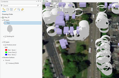

I'm trying to symbolize a tree point layer as the trainer does in the video but my 3d tree symbols come out looking like white hollow cylinders (image below). What could I do to display the proper 3d tree symbology?

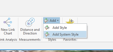

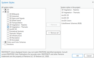

1. First make sure the System Style for vegetation is added to your scene by going to the Insert Tab and clicking Add, System Style
make sure the vegetation styles are checked that you want and click ok.

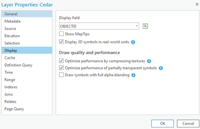

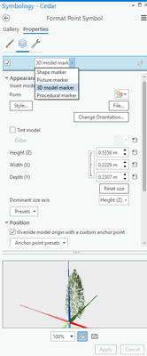

Step 2 is to set up your points to display properly in a 3D world, so open the Contents and right click your tree point feature class, select Properties, under Display make sure "Display 3D symbols in real-world units" is checked.

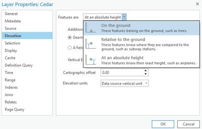

If your points were not created in a 3D environment and are not Z-aware, go to Elevation and select "On the Ground"
Step 3 is to symbolize your point layer properly.  To do that open the tree point layer symbology and make sure 3D Model Marker is selected like below:

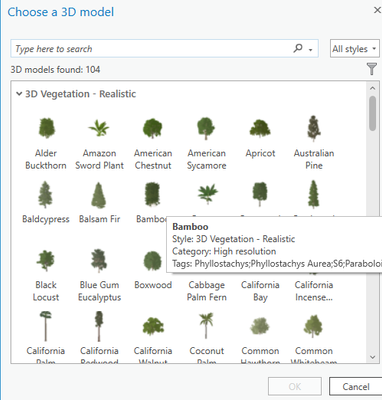

Step 4, click Style, then select the shape of tree you want.
If all of your trees are to be shown the same height, you can just enter that height in the symbology.  If the height varies, I have more steps for you to follow.  Let me know if you need to do that.

Do you have the instructions for applying a height field to these symbols? When I use the Extrusion types, I get weird grey circles like in the OP's post..

I went through these steps like you said, and I am still getting the circles the author of this post was.
Any further suggestions?
