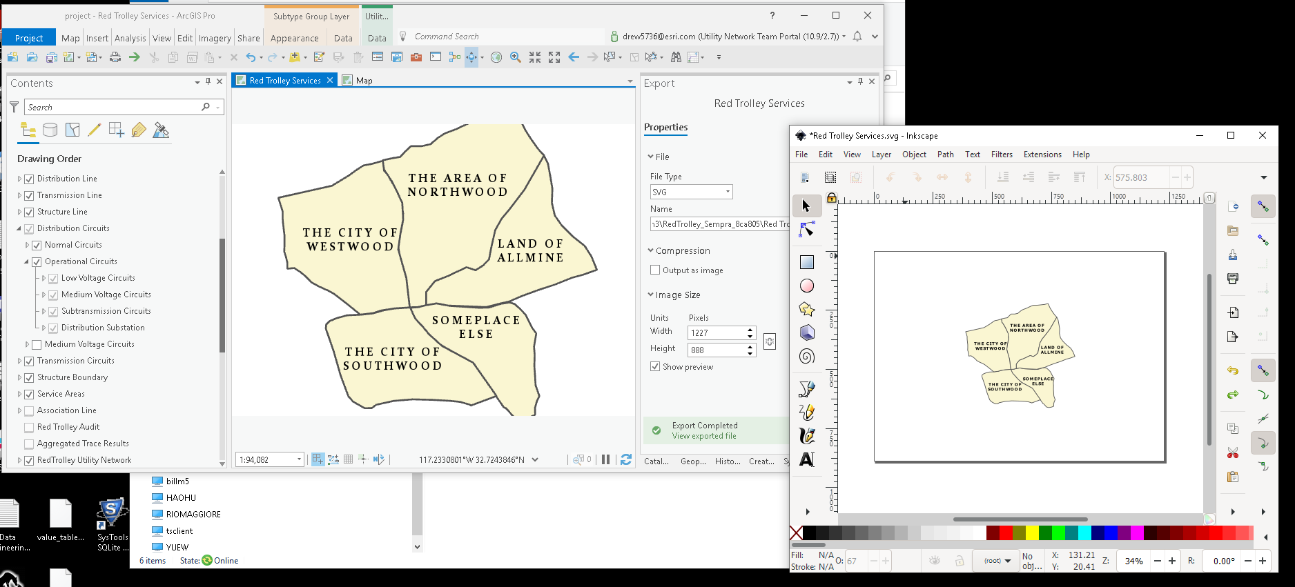

Here is my exported svg viewed in Inkscape. Ungrouping all in Inkscape gives me complete control of all the graphical elements and labels.
