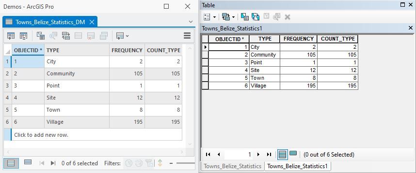

But, what ALL I WANT is the Count (or Frequency). So when I'm forced to choose the Count Statistic, the result is two columns; one for Count and one for Frequency, and they are the same! It feels redundant.
...Why both?

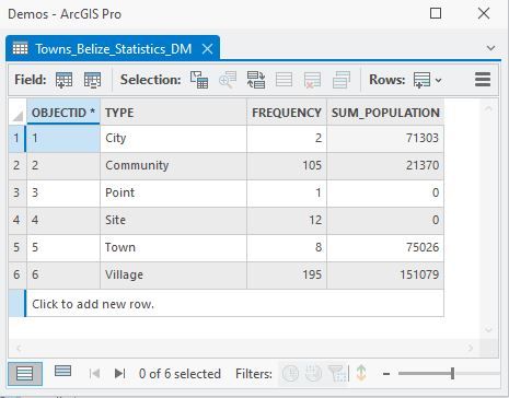

Great question for which I don't have an answer...yet!  I'm running ArcGIS Pro 3.0.2 and ArcMap 10.8.2 and my Summary Statistics outputs are identical with Frequency and Count.  I see what you're saying about redundancy with this scenario.  In other scenarios say POPULATION and a SUM based upon TYPE of community, the COUNT field is not present but FREQUENCY is as well as the SUM_POPULATION.  You mentioned that ArcMap was different.  How so and what release of ArcMap are you using?
