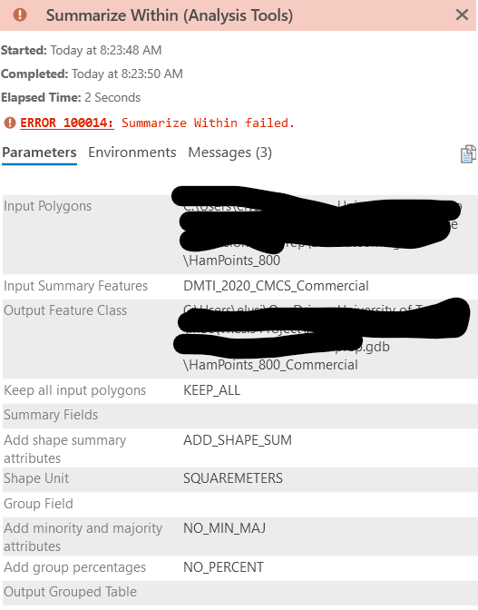

The summarize within tool suggests its Error 100014 but when I try a file name right in the C:/ directory the same error occurs.

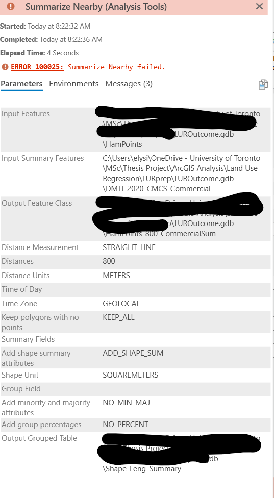

Summarize nearby gives me error 100025, and I can't find any documentation about it.

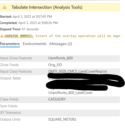

Tabulate intersection gives me this error, again not sure why. Any insight is appreciated.

However, I continue to use summarize within (without category as a group field) and the error 100014 shows up. I can't find any information online about this error? Any idea what might be happening?
ShaunWalbridge
Any chance you're using the version of Summarize Within designed for online analysis? I would only expect that error when using the standard analysis version of the tool for working with online features. If it is happening with local data, please provide a more complete example of the inputs and error.

I got error 100025 with summarize nearby with a non-descriptive error message in Python. I was running it in a Pro Notebook, so the failed GP run went into my GP History. When I double-clicked on it to see the settings in the Pro GP GUI, it popped up a login to my Portal. The layer I was summarizing (Input Summary Features parameter) was a hosted feature layer on a portal, but my session had timed out.
As always, I wish the error message was more useful. I might've eventually figured that out, but it would have taken me much longer without the help from the Pro GP GUI.
