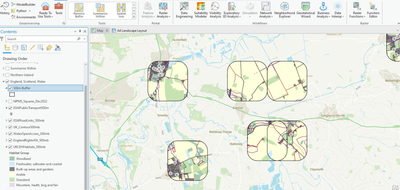

I am trying to summarize multiple layers into a single output. Ideally, so when someone selects one of the 500m Buffer Squares, they are able to see a count of the number public transport points, roads, rights of way and habitat features which occur within that square.
So far I have tried using the 'Summarize Within' tool for each layer and then merging the summarized layers together, but this seemed to leave a lot of the attribute information behind and show as 'null' when I could see they were present in the individual summary layer.

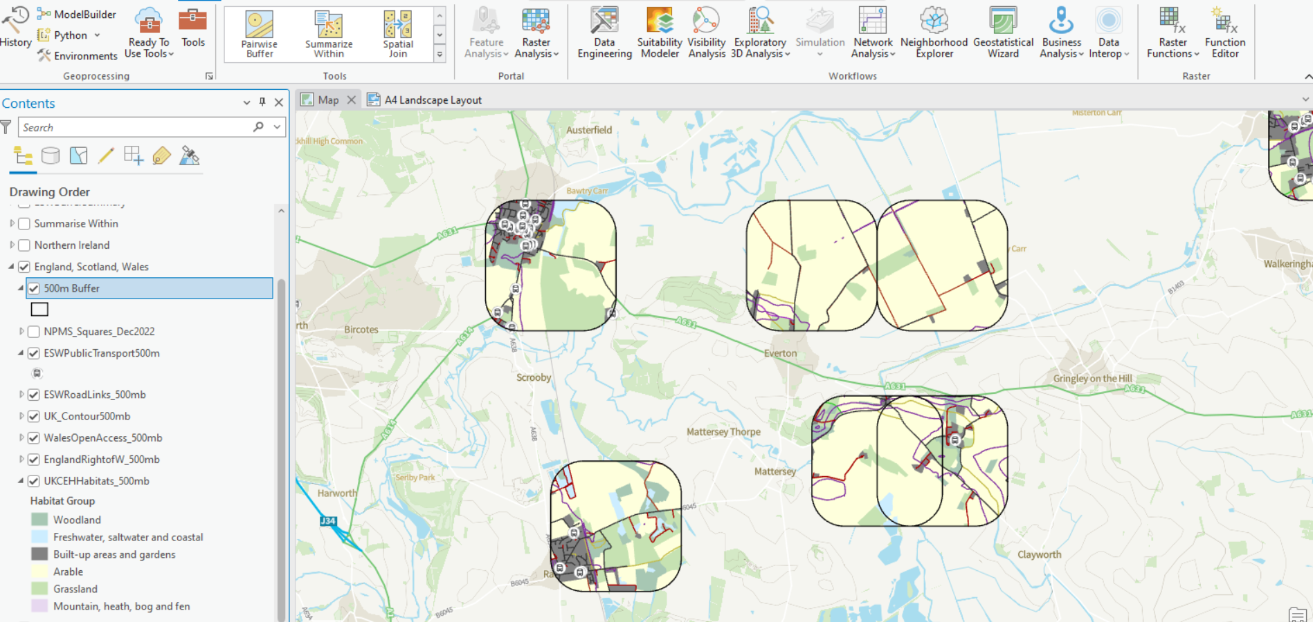

I would like to keep the squares whole which is why I haven't tried the intersect tool as I don't want the areas that overlap (as shown above) to be made into new features.
Does anyone have any suggestions?

Maybe try the Spatial Join GP tool with a match option of Contains
