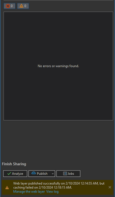

Arc Pro 3.1.2. I am trying to write it to a shared folder in a GDB as a raster. I am staring at what i believe is a suitability map but for some reason after clicking run i get that error. The Locate Regions tool is able to read the suitability map and output regions, Albeit I ran in the standalone geoprocessing tool outside of the suitability modeler pane. However, my main goal is to upload raster as a web tile layer into AGOL. I tried publishing the suitability map but caching failed.
Bobcat94_0-1707586147246.pngBobcat94_0-1707586147246.pngBobcat94_1-1707586183236.pngBobcat94_1-1707586183236.png

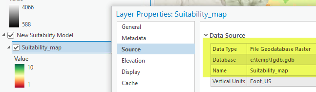

Right click the Suitability_map layer in Contents and pick Properties, post a picture of this

I just had the issue in ArcGIS Pro 3.5.2 (today 13 August, 2025). Thanks for the workaround @SteveLynch
