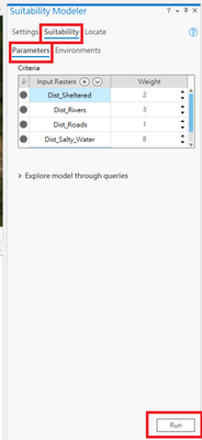

When using the suitability modeler, after setting my functions and weightings, the Run button does nothing, in both the tab and ribbon, so I am unable to use the locate function as it is 'Missing full resolution suitability map' Is there something I am missing or is it just mugging me off? I have tried withjin a new project, a new model, and with data and it just doesn't work. Pressing the run button, quite litterally results in nothing happening.
Using the latest version of ArcPro. Thanks all!

I'm sorry to hear that you are having a problem.
After pressing the Run button on the Suitability pane, please have a look at the properties of the Suitability map. Does the source point to your project's gdb?
and also please tell me what version you are using 2.7 or 2.7.1 or ?

It points to the default .gdb within my project folder. If I navigate to it through catalog and look for the name of the suitability map, there is nothing there. I am currently running 2.7.1.

ycchuah
Hi GandCrab:
I face the same problem too. After click Run in the Suitability tab, my problem solved. Hope this work for you.
TaraReid-OBrien
Thank you! I ran into this problem to day, and that solved it for me, as well!
