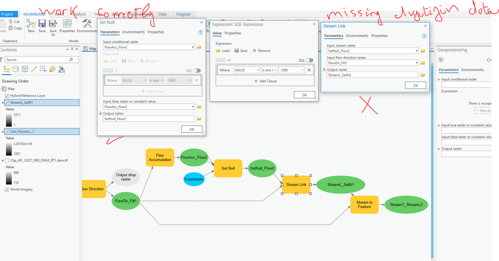

first, I try to convert my "set null dem of flow direction" to stream link but the problem I have that not all raster of my dem  converted to steam link soo why that happens ?
note that: I use both ArcGIS pro 2.5 and ArcMap 10.8 and get the same problem
See picture below :  

Could you kindly post the expression you used in the Set Null tool?
I usually use the Con tool to apply a threshold to flow accumulation raster to create a stream raster, which I then use to Stream Link tool.
You can try the Con tool instead of the Set Null to see if it helps. If nothing works, I would be interested to get your data for taking a closer look if you can share.
Thanks
Noman

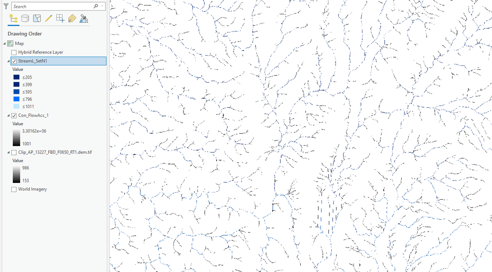

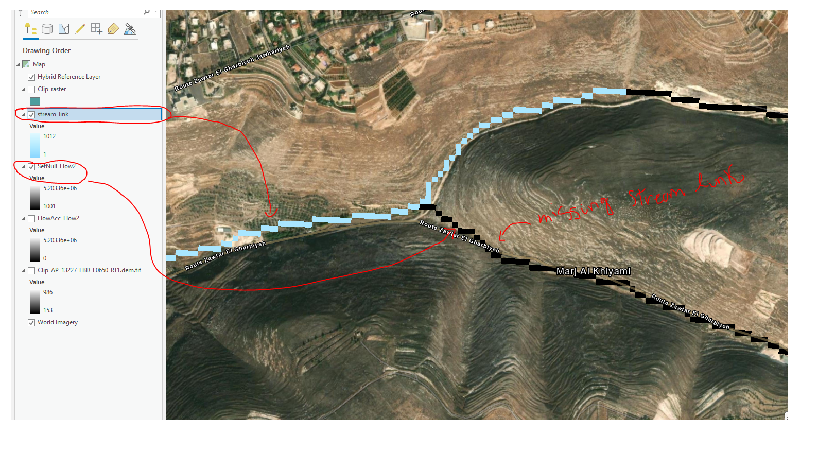

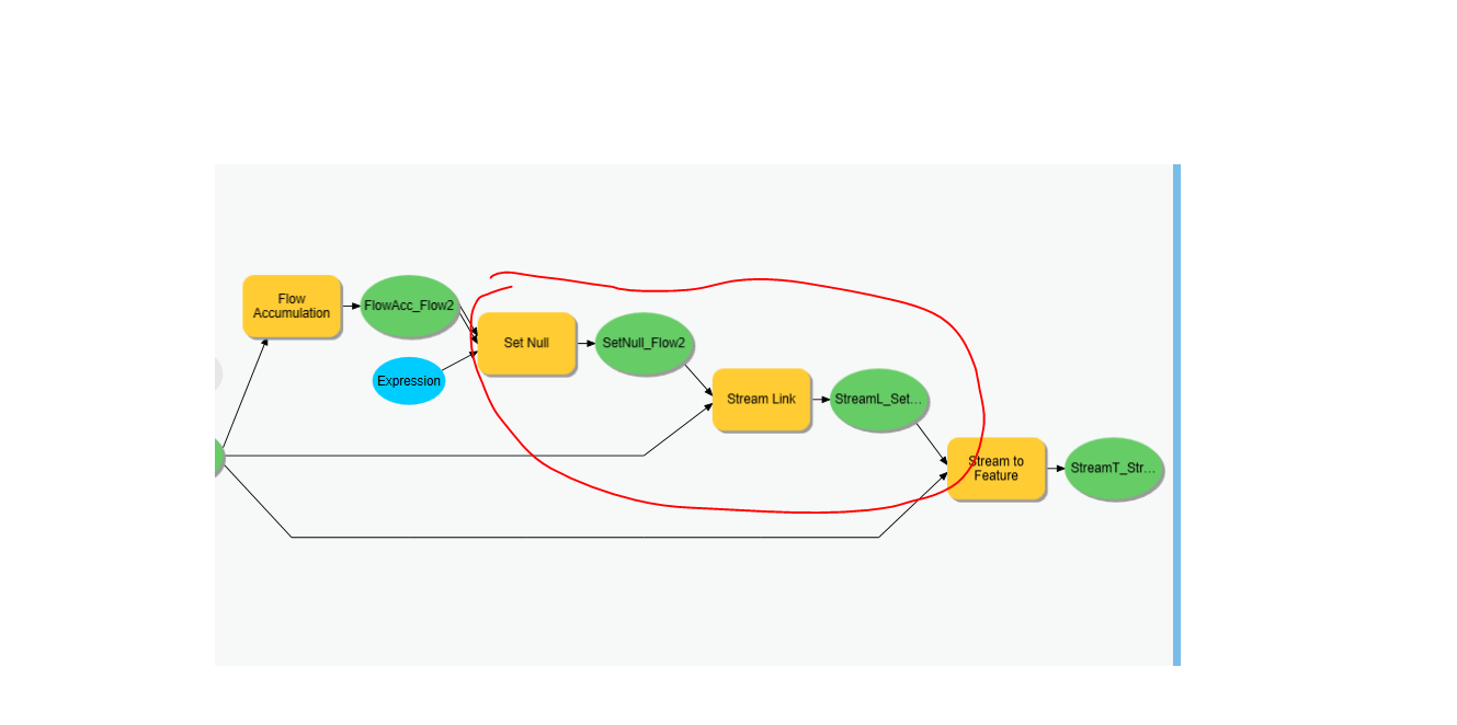

second set null work correctly but convert "set null dem to stream link" make issue like show in the picture above and I try con tools and get the same issue
and here more picture to see what is going on
