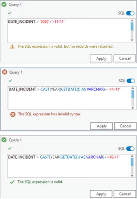

Still having issues with trying to generate a dynamic valid SQL expression for current month, even if records are not returned in ArcGIS Pro 2.5.2?
Below are three examples, the first example is string based and valid but does not return a result. The second example use some functions to generate the year using the same month and day as a string and theatrically generates the same value as the first example but expression is deem invalid. The third and final example, uses the syntax from the second example and has the month reduced by 1 (this returns a record) and is considered a valid expression.
Can anyone advise me on an appropriate solution?
ejrcarson
I tried the second invalid expression in ArcMap and it was successful.
