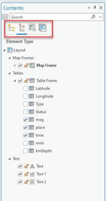

AubriKinghorn
Maybe the List by Element Type option on the Contents Pane would be helpful here? I like it when I'm trying to move text elements but not the map or table.
Cheers,
Aubri
