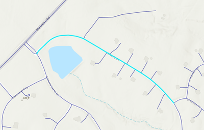

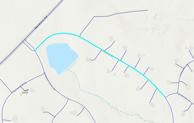

I am trying to create a new layer which merges my street centerline with my driveway layer. Next, I want to have each segment split at every intersection. Below I show what happens once I combined the layer. The street centerline does not break at every intersection into a new segment.

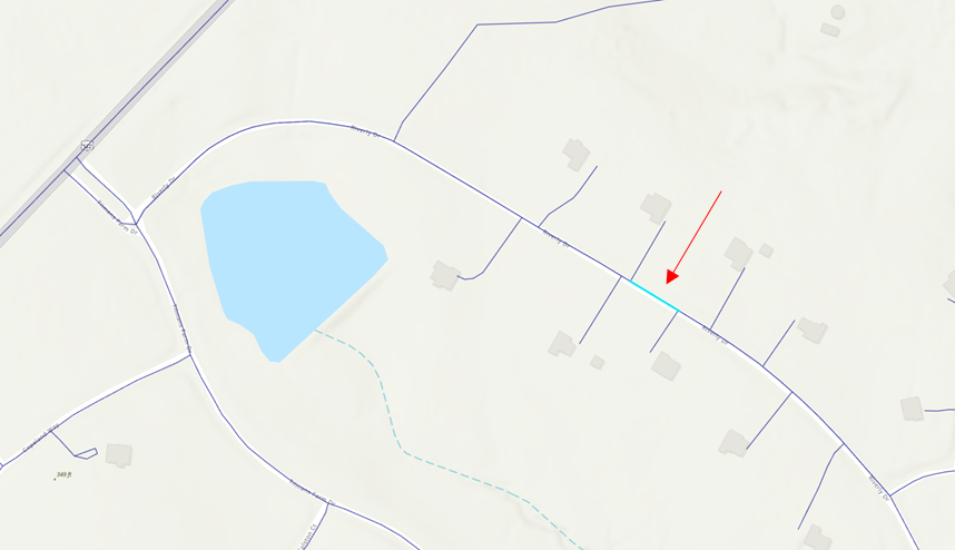

What I want instead of the one long segment that passes by several driveways, is to have multiple segments, which changes at every driveway juncture. Below shows what I'd like to be able to select.

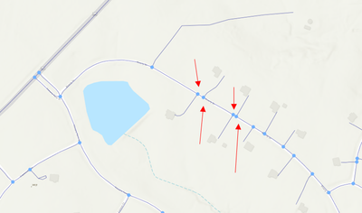

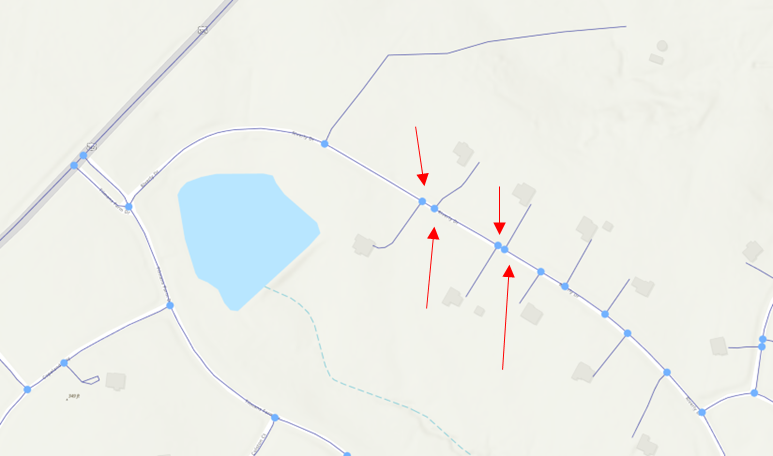

After running the Merge tool, I ran the Intersect tool to create a point layer showing where the junctures between segments occurred. With the intersections showing below, is there an automated way or tool that I am missing that will split the segment at those intersections as defined below?
I tried Data Management Tool (split line at point), but that didn't work. Is there another tool out there that would work better?
