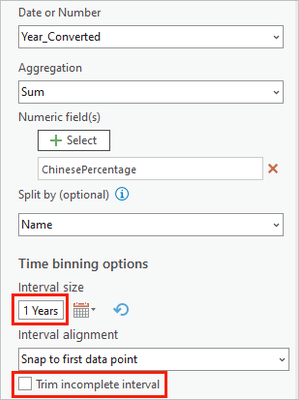

Hi, sorry for the late reply. It's not a bug with 3.0 but rather some new behavior which unfortunately we didn't reflect in the tutorial. To complete the tutorial in 3.0, you should make the following changes in the Visualize trends with a line chart section:
Step 10: Set the Aggregation setting to Sum. (It should be the default setting.)
The Split by option is now enabled and you can complete Steps 11 and 12. Now make a couple of adjustments:
  • Under Time binning options, change the Interval size from 2 Years to 1 Year. (It doesn't make sense to sum percentages for multiple years.)
  • Uncheck the Trim incomplete interval box. (Otherwise, the last year of data is omitted.)
In the English UI it looks like this:
We will definitely fix the tutorial steps for the 3.1 release; I hope we can make a fix sooner in a patch. Thanks for bringing the problem to our attention and, again, sorry for the late reply. With quick-start tutorials, or any other documentation, you can also use the Feedback on this topic? link at the bottom of the web page to report problems.
