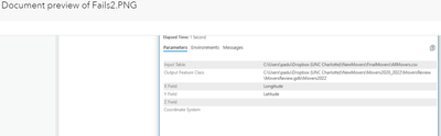

One thing I noticed in one of your screenshots is that the Coordinate system is blank:

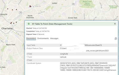

See below, this is what I'd expect to see:
