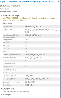

The tool runs perfectly except that it still uses default extents. Thus far I haven't let it loop through to run the command a second time because it takes 4 hours to run on the entire raster rather than the extents I want it to run on. Any ideas would be much appreciated! I have ArcGIS Pro 2.7.3. Here are some screenshots.
Here is the report from the history window the time the tool worked from the geoproccessing window.
This is the my most recent run (currently being processed) that should have extents set:

When you have these sorts of problems, it is always good to get the simplest set of inputs to test with. I suggest creating a test featureclass with just 2 polygons in separate corners of your image. Then try and export the training data for just one of them using the extent parameters. Also try doing it just like the above, without using variables.
Also, one of the reasons it may be taking 4 hours is that you have specified the rotation angle as 45 degrees. For each image created it will create an additional 7 images (going around in 45 degree increments), and could therefore maybe take up to 7 times as long. This will also make your deep learning training much longer as well. Normally how this is handled is that when you train your model you tell it to transform your input images by randomly rotating them. So you get all the benefits of more training data but without pushing huge amounts of samples through the model.
And one more thing from that warning message - it's probably a good idea to define a class value for your data, just in case that causes other problems later. Just add a field called Classvalue (as a Long) to your polygons and set it to 1. Then choose that field in the parameters.
