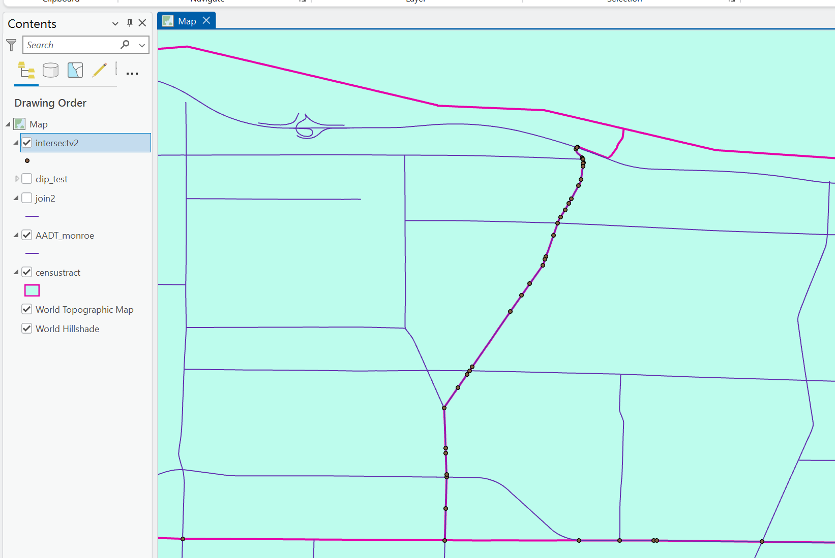

I'm brainstorming a scenario and the best way to address it - I'm working with a professor that has a line file that needs a spatial join with a polygon layer. Easy enough, however, we're running into an issue (that I was expecting to happen) - many of the lines are overlapping with the polygon boundaries so I'm trying to reconcile that.
For example, I ran the intersect to see where the spots are where the line overlaps with the polygon boundary. A point represents every part of the line that zig zags over the polygon boundary. The polygon boundary is highlighted in pink and the line is purple:
If it was a typical situation, I would split the lines at the points, and then it would give me a little more accurate count if I ran the spatial join and where it is located with the polygon. But I know in this case, the overlapping lines are a bit of a sticking point.

DavidSolari
MVP Regular Contributor
If you run an Intersect between the lines and the polygons it outputs multipart features, one for every combo of line and polygon intersection. If you select the longest line for each group of line IDs you can use the polygon ID for that feature as your answer. Summary Statistics + Join Field should get you there.
If "what polygon has the most overlap" doesn't answer your question you'll have to provide more details on what you're trying to get out of the analysis.

Hi @SaraJL,
Another option you can try is:
  1. Dissolve the line features by a common field value to create a single line/multi-part feature.
  2. Create a point feature using the centroid of the line.
  3. Spatial join the point feature to the polygon.
  4. Join the spatial joined point back the line feature using the IDs of the line feature.
This would be my recommendation but there are other ways to tackle this problem.

RhettZufelt
MVP Notable Contributor
I've had similar need, but in my case, most of my lines crossed the polygon instead of following it.
I used the Feature To Line tool with my line layer and the polygon layer as inputs with Preserve Attributes selected.
This creates a fc with all the lines, both polygon outlines and the input line fc data, split at the intersections, with attributes from each.
I then select all features in the output that have a null value for the copied over ID field from the lines.  This way, I'm selecting only the polygon boundaries (as they don't have that particular ID field) and then I delete them.  Then I delete the un-needed polygon attributes that were carried over to the lines.
This leaves me with an attributed copy of my line input data that is split at each of the polygon boundaries that I can use for my spatial join(s).  Have not run into it myself, but the Feature To Line tool has 'some' flagging/handling of coincident lines/boundaries as well.
Different scenario, but thought I'd put it up here as don't think that is what that tool was originally intended for.

RhettZufelt
Did you try the Feature to Line tool?
Don't have your data to test, but my testing splits all the lines exactly at the polygon boundary so that the one to many spatial join has a single match for each line segment.  It also retains all the attributes as well.

D_Atkins
So the real problem is: the tract boundaries are intentionally drawn along the road (or the road built on the bounds).  Splitting the lines as they criss-cross the boundaries is taking advantage of spurious precision in the geometry, and not resolving the methodological questions:
If a road is supposed to be approximately on the bounds, do you want that road to inherit attributes from the 'left' polygon, the 'right' polygon, or from both polygons?   Should the result be a summary of both 'coincident' polygons?
This question really needs resolved before tackling the geoprocessing -- otherwise, as your images show, determining which 'polygon' the 'road' belongs to is about the same as a random roll of data precision and map projection.
As for the geoprocessing steps and tools: Intersect (Analysis)—ArcGIS Pro | Documentation should be all that's needed to split lines by polygons.
Then, Spatial Join (Analysis)—ArcGIS Pro | Documentation to update each line segment with the polygon id below.
If you're having trouble with these tools (or their results), I would consider a thorough review of your spatial references.
