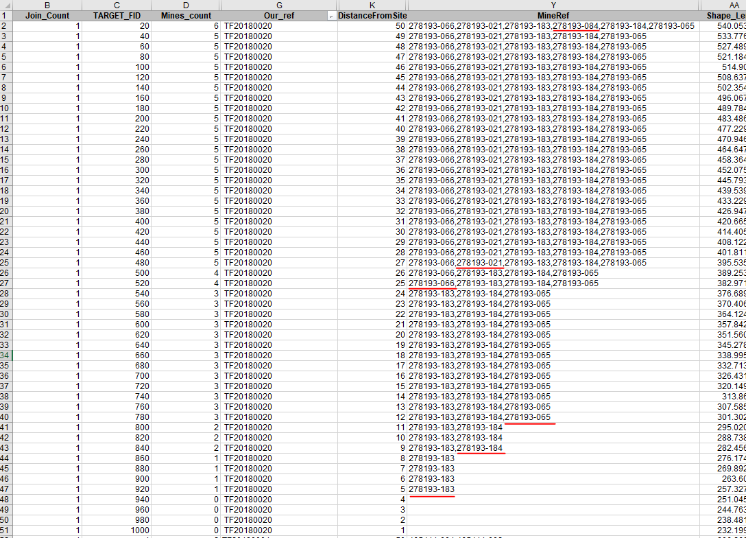

So what I'm doing here is:
Multi-ring buffering a site boudary polygon layer 50 times (50x1m buffer discs). Then each distance buffer disc is spatially joined to a Mine location point layer. I'm then able to export the joined layer to Excel and view the results in a table:
As you can see above, each row is a buffer disc of one property boundary. In the image, each red underlined Reference number represents a new mine being spatially joined to the buffers feature class.
Look at the DistanceFromSite field- between 1 and 4m from the site, no Mines are present.
At 5m away, a single Mine is found.
At 9m away, another mine is found and the attributes are added to the MineRef output field, delimited with a comma.
At 12m away another mine is found and the same happens.
Now when we get to 25m away form the site, another mine is found BUT the attributes for that mine are not added to the end of the output string in MineRef. Instead they're added at the beginning!
At 27m, the next found mine is added as the second entry in the string.
At 50m, a final, 6th mine is found. But again, it's added into the output string as the fourth entry (see red underlined Mine ref at the top of the image).
So in conclusion, I found that the MineRefs are being sorted by their OBJECTIDs. How can I sort it by order in which they were found/added to the spatial join output string?
