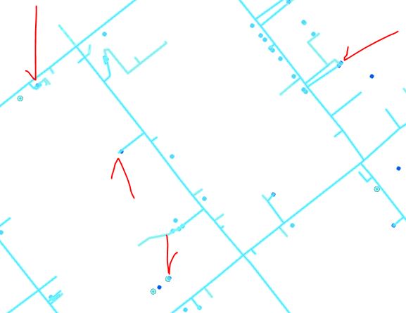

Agree.  It is/was a useful and time-saving tool in ArcGIS Desktop.  Esp. considering how ArcGIS Pro renders selected features, which visually obscures small unselected features.unselected features obscured by rendering of selected features.
