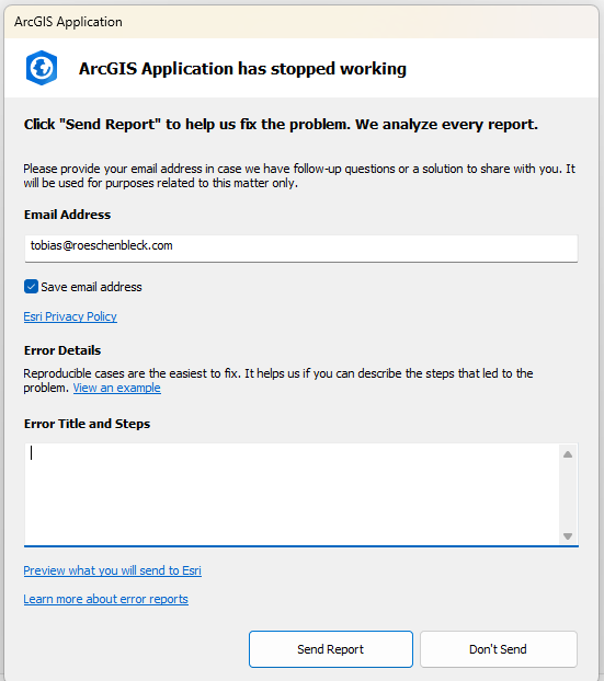

When I try to start ArcGIS Pro 3.1 it loads and immidately crashes and shows this Window. Has anyone encountered this Problem and can help?
Edit: SOLUTION: I reinstalled my graphics drivers and update the Arc GIS Pro 3.1 Deep learning Libraries. This fixed the Issue for me. Deep-learning-frameworks

Hi @TobiasRoeschenbleck
Does your machine meet the requirements for ArcGIS Pro 3.1?
You can run the following system checker to confirm any missing components.
System Checker
System Requirements
When Pro crashes it creates a dump file which can be accessed from the following directory
  • These can be found in C:\Users\<username>\AppData\Local\ESRI\ErrorReports. Alternatively, you can access the folder with %localappdata%\ESRI\ErrorReports
What is the workflow when ArcMap or ArcGIS Pro crashes?
The dump file will indicate what module is causing the crash and this should help point you to a resolution.
Normally a clean uninstall works in this instance.
Clean uninstall
