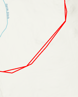

I'm trying to snap a feature class 1 output to another polygon feature class 2. I am not sure why it's taking forever to complete the task.  The polygon feature class 2 is relatively big, because it takes around 2-3 minutes to load. Could that be the reason? Have you encounter this problem before and how did you resolve it?
I was also wondering why when I tried to snap feature class 1 by edge type, it does snap to feature class 2, but it also kept it's original unsnap position as well? Please see the photos attached. The first photo shows only feature class 1 (red polygon outline) with the top line as the original position and the bottom line as the snap positions created after snapping feature class 1 to feature class 2. The second photo shows the blue outline of feature class 2, which align with the snapped outline of feature class 1 (red polygon outline).

In the top photo on the upper right, there appears to be an outward segment suggesting that the features don't have the same number of segments.  Can you confirm the number of vertices in both features (hence segments).
See Snap (Editing)—ArcGIS Pro | Documentation for some other possible issues
