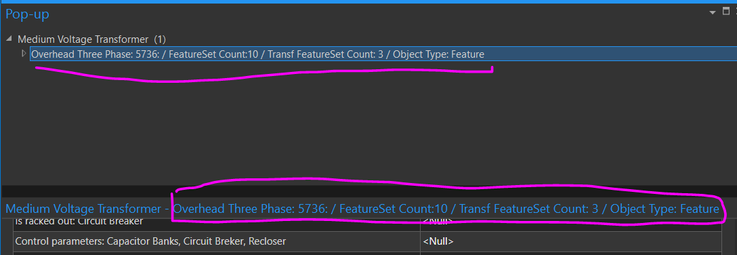

I confirmed that the FeatureSet returned by the FeatureSetByRelationshipName was not empty with a count and also used an If statement to check if "t.assetid" was "Null", before posting the question.
You can see below the and image showing the the FeatureSets are not empty, before and after the filter function.
var results_FS = FeatureSetByRelationshipName($feature, 'R0L100Electric_DeviceL1508Device_Unit', ['*'], false)
var fs_cnt = Count(results_FS)
var transf_FS = Filter(results_FS, "assettype = 785")
var transf_fs_cnt = Count(transf_FS)
var t = First(transf_FS)
var s = TypeOf(t)
domainName($feature, 'assettype') + ': ' + $feature.assetid + ': ' + '/ FeatureSet Count:' + fs_cnt + ' / Transf FeatureSet Count: ' + transf_fs_cnt + ' / Object Type: ' +  s

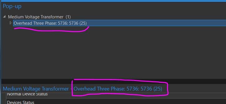

Now, after adding the check if the Feature is "Null" then the code passes the validation and also returns the fields from the related record. It looks like the code validation requires handling the exception of possible "Null" feature before being able to access the fields. As you can see in the image below the code is able to get the fields and show them in the Pop-up, so it was never "Null".
if(t == null) {
        return "Some default value"
if(IsEmpty(t.assetid)){
     return domainName($feature, 'assettype') + ': ' + $feature.assetid
} else {
    var id = t.assetid
    var power = t.powerrating/1000
    domainName($feature, 'assettype') + ': ' + $feature.assetid + ': ' + id + ' (' + power + ')'
