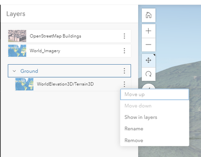

Hi @ScumBagsSurfer ,
I hope this helps. If you go to the properties of the Ground > dem, you can show/hide this in layers. Now you can under layers switch on/off your dem to get a realistic 3D presentation.
