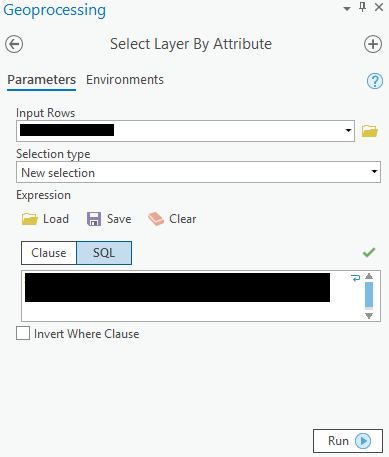

It's very tedious switching to the mouse to run the tool. I am looking for a key combination (Ctrl+Enter, F5, F9 or whatever) to run a geoprocessing tool.
Does anyone knows which shortcut is used here? Are there any shortcuts at all?
In other words, the cursor is still inside the expression text field and I want to run the script without switching to the mouse and click on the run button.

Thank you but I am looking for a shortcut to execute the geoprocessing tool while editing its parameters (e.g. changing the expression in the Select Layer by Attribute tool).

You can create a Task with the Select Layer By Attributes geoprocessing tool embedded in the task step. The Run button on the Task step can be activated with Alt+X.
