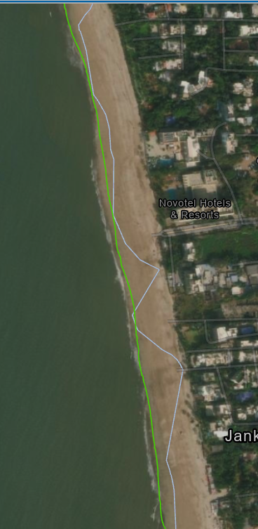

Hi, I have two Line Features depicting shoreline extracted from 2023 and 2024 satellite imagery. Now I need to measure the net change (acres eroded or accreted in the coast in the span of one year). What would be the way to do so in ArcGIS Pro?
