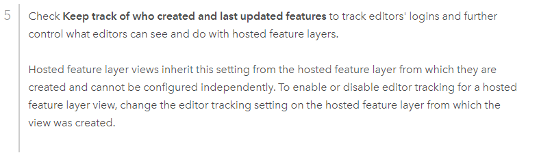

KoryKramer
Esri Esteemed Contributor
Since you're working with a service in Collector, it sounds like you're looking for the built-in functionality of keeping track of who is editing.  Check out https://doc.arcgis.com/en/arcgis-online/manage-data/manage-hosted-feature-layers.htm#ESRI_SECTION1_0...
