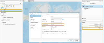

Regarding the units issue: The Z units for the Move To tool are read from the Elevation Units property of the map or scene:
Does that help?

In your original post, you mentioned the Z unit of the Move To tool's Delta method, is that correct? Can you provide a similar screenshot to what I showed above (map properties > general). FYI you will need to close and re-open the Move To tool to see the change in units reflected in the tool.
