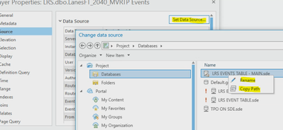

  I'm not finding anything about Project--> Databases in the layer properties at all.  Just the "Set Data Source" under the Source tab in properties (see below).
 If this is what you are talking about, then I am getting the same 2 issues as previously mentioned.  If not, I guess I'm a bit confused where to find the Project->Database in the Maps layer I'm trying to relink.

When you click "Set Data Source" this will open another window, in the new window try to go to Project->Databases and see if you can set it there via the "Make Default" eGDB.
PeteJordan
Nope it just only allows me to "rename" or "copy" this is the same if I'm clicking on the LRS Events Table or the Default Table.
You will also notice the red ! beside 2 other LRS Event tables.  For some reason previous connection just seem to randomly get lost and I don't want to delete them yet until I have all the other maps updated in case I lose data.  (another issue)
