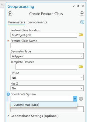

I use a default projection for my project, and its maps
Then when I create a featureclass, I select the coordinate system of the map
