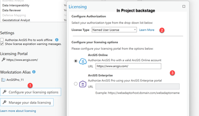

This is what I use and it works fine for me. Also Named user licencing is the default for ArcGIS Pro.
@Nirby is your computer managed by IT? Would they be forcing users to use the concurrent licencing by default? This is something you can do with registry keys and app settings, and would want to explore if you have a limited number of advanced licences.

The only other place I can think of is from the Licensing options in the project backstage.  I have never had to set or change it, but it might be worth a look for you.

Nirby
So yeah this is what I'm using to switch to my named user license after ArcGIS launches with the concurrent use, but the settings don't "stick" if that makes sense. It just defaults back to concurrent use with every new instance.
You bring up a good point about checking the registry keys and app settings with IT, I'll look into that. I'm the only named user at my organization, so that might explain why it may be defaulting to concurrent.
