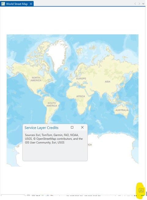

The layout dynamic text element for Service Layer Credits should match the same information you get when viewing the services in a map view by clicking the button in the lower right corner of the map view.  In the image below this button is highlighted in yellow.  Clicking this button brings up a pop-up window with the credit information. This information is provided by each service within the map.

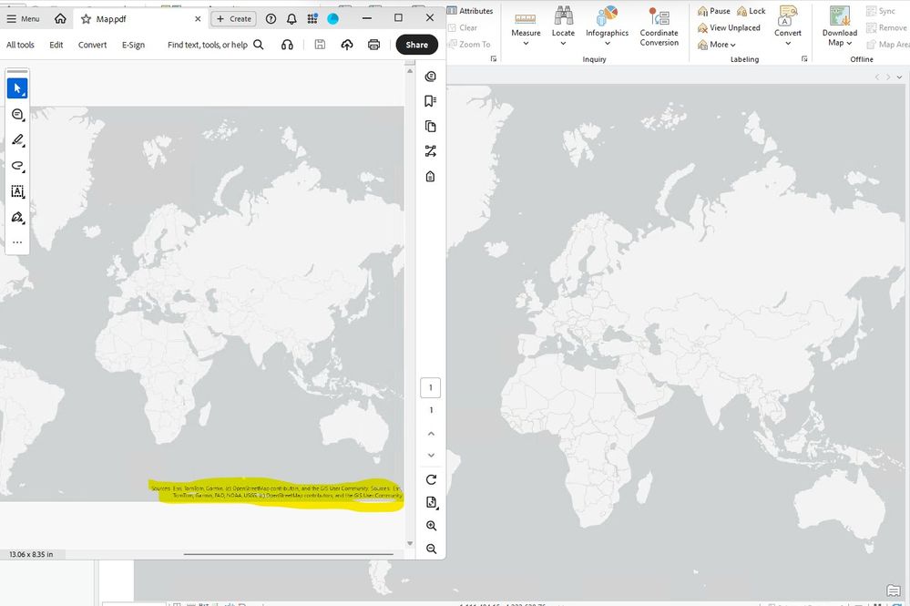

If you export the map from the map view (no layout) you will see the same credit information displaying in the output (highlighted yellow in the image below).
The layout dynamic element should display the same information for each unique map/map frame on the layout. If you do not have a Service Layer Credits element in the layout the credits will draw withing the appropriate map frame.
