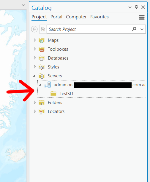

I have an instance of ArcGIS Server running as a standalone installation. I am trying to setup ArcGIS Pro to be able to publish services to the server, and I am able to connect to it from ArcGIS Pro but only with user privileges, not publisher or administrator which are required for the publishing I need to do.
Here is a screenshot of the catalog section showing that the connection is present (it has detected an empty folder I added, so there is evident communication):

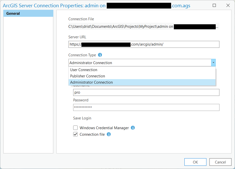

When I right click on the server and open the properties menu I have the following:

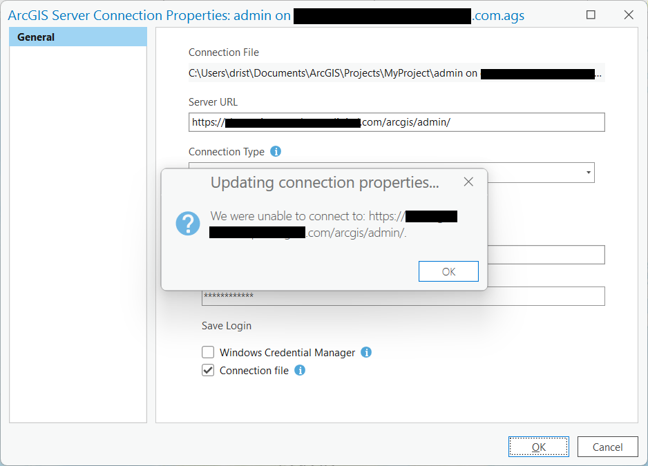

The publisher and administrator options are available. So I click ok and get this next message:

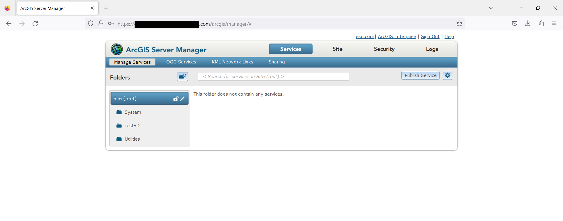

This is strange because there is certainly a connection, and I am also able to log into the ArcGIS Server Manager directly from a browser as shown here:
