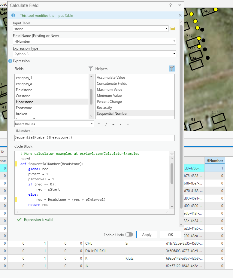

Hello!
I want to sequentially number only particular features (headstones) in a table with location data for different types of stones, and I'm having trouble figuring out how to code this in Python.
I keep getting errors when I use SequentialNumber() and try to call the headstone field in the code block. Typing !Headstone! instead gives a syntax error.
Basically, I want to be able to number (and later label) only the headstones. Their order in the table is important too.
 Is there a better way to do this? Any help would be greatly appreciated!
RhettZufelt
MVP Notable Contributor
rec = Headstone * (rec + pInterval)
When the "Headstone" value = 0 (not a headstone), then "rec" becomes zero as you multiplied it by zero.
    if (rec == 0):
        rec = pStart
So, the next row, since it now see's "rec=0" will reset to pStart.  That is why it is "resetting" when not a headstone.
You can simply put a definition query on the layer where Headstone = 1.
then just use the SequentialNumber() as is and it will only calculate the sequential numbers for the Headstones (rows included in the definition query).

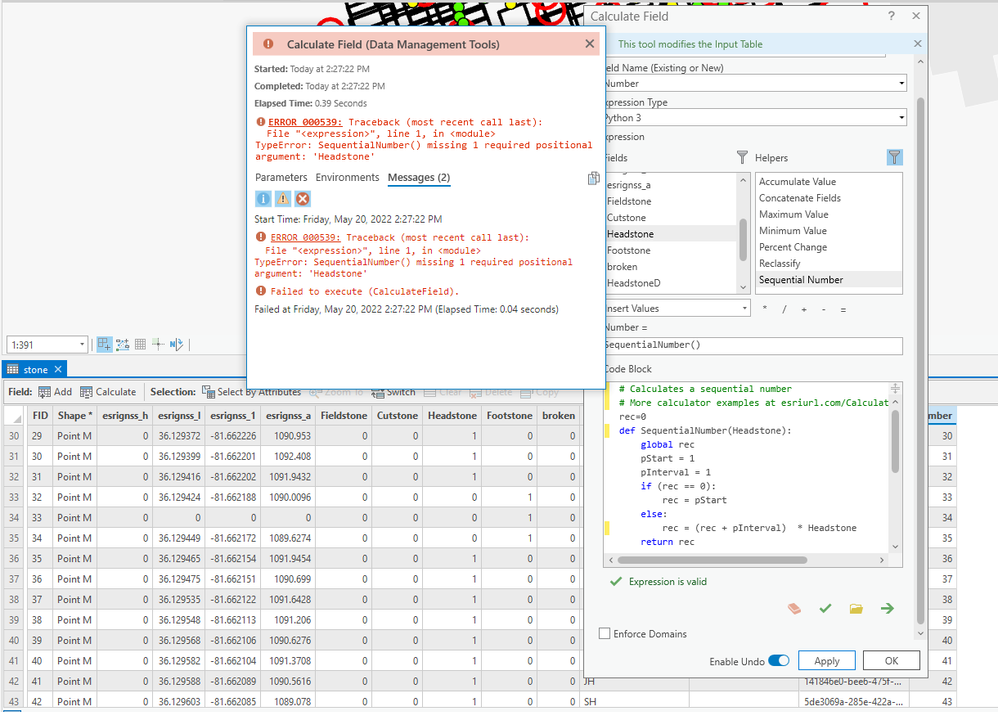

AlexZacher
Hi Andy,
Thanks for your response! I have tried that. I get a different error with that method, stating:
ERROR 000539: Traceback (most recent call last):
  File "<expression>", line 1, in <module>
TypeError: SequentialNumber() takes 0 positional arguments but 1 was given
Failed to execute (CalculateField).
AndyAnderson
And was the function still written as in the picture above?
def SequentialNumber(Headstone)
This variable Headstone is different than the variable  !Headstone! used to call the function.
— Andy

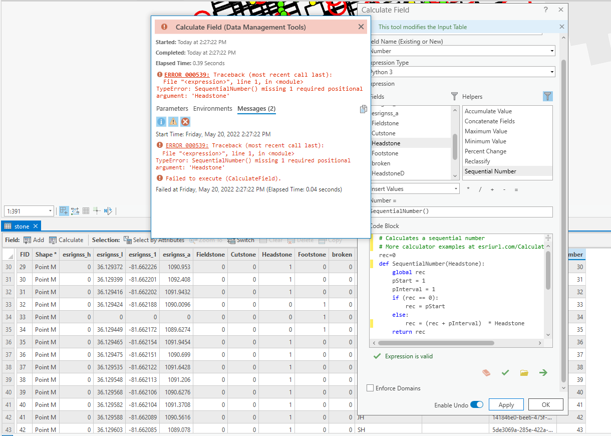

AlexZacher
I see! It was not when I got that error.
With the changes you suggested, the calculation seems to work, however, it is only applied to the first row of the table -- see the highlighted cell below.
I did initially try to sort the values in the Headstone field by descending order, thinking that I might sequentially number the rows after sorting them, then ask ArcGIS to stop labeling after a certain value. But the sorting method I tried seemed temporary, and I had some issues with field calculations getting stuck in the first row after that.
AndyAnderson
The calculation is only applied to the first row because you have it selected. Click the deselect button at the top and try again. (This is a “feature” though one that I often forget to avoid!)
— Andy
