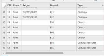

@JohannesLindner thank you very much for your time on this and the suggested code.  However, i wonder did i over complicate my query.  Extract of my data below. you will see that the "Church" features do not run sequentially in the "Mapref" order.  Data in rows 15 and 15 (both Churches) goes "B66" then "B72".  I have executed a sequential order of the Mapref column.  I just wonder do i need to tweak the code so that all the 'Churches' are in numerical order i,e, "B66" then "B67"?  (i did ensure that the 'Type' column was arranged in alphabetical order before running the sequential numbering in mapref).  My sequential code is below.

JohannesLindner
MVP Alum
Calculate Field does not care about how you sort your rows, it will iterate through the table by ObjectID.
It might be possible to change that order in the code block, but it's much easier to just do it in pure Python. Calculate Field is nice for quick and simple calculations, but it is very limited.
