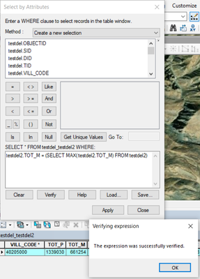

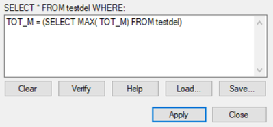

In ArcMap, I can open the table > Table Options > Select By Attributes.
Use a similar expression
FIELD_NAME = (SELECT MAX(FIELD_NAME) FROM TABLE_NAME)
Try
Easting = (SELECT MAX(Easting) FROM RealPosition)
