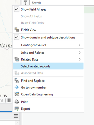

You want to set up a Relate , then open the structures table, hit the hamburger menu, and select "Select related records"
This will automatically select the row(s) related to your structure.

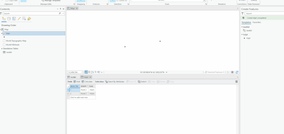

See this gif below, where I do this with an origin point feature class (tstpt) and destination table (tsttbl), related by the points' ObjectID.

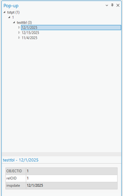

As a bonus, you can also see them in the popup after adding the relate
