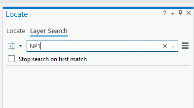

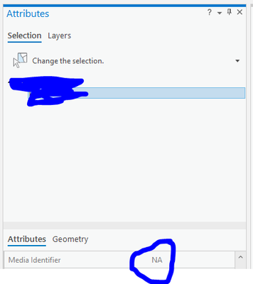

For example: I cut and paste the facility # to search by facility # in 'layer search' and when arc map finds it, I select the facility (in an edit session). Then in the features attributes I select the field I want to update then cut and paste from the ID# list in excel to update the field.  There are over 400 of these and I hoping to find a quicker work flow.
