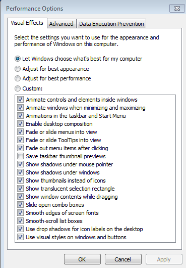

Scott_Harris
Thank you. hmmm... ok another question: Is DWM.exe running in the process list in Windows Task Manager?
GabrielMarcus1
Yes. Doesn't it always run in W7?
Scott_Harris
It should be running, but I've seen a case where it was not running and this caused the same issue described here. Once it was running again, the issue was resolved.
What theme are you using in Windows? Surprisingly, in non-esri forum someone found where changing the theme resolved a very similar issue. See: Windows leave trail when dragging in Windows 7 on new machine | AnandTech Forums: Technology, Hardwa...
