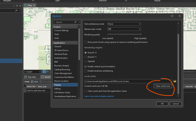

Sometimes clearing my ArcPro cache fixes some random problems I have. esri support has recommended this to me in the past as well.
OverstoryGIS
thank you! I'm not sure who I've angered, but I did that and now everything is really broken. It's been spinning for several minutes just trying to load the map when that was the one thing it did before 🤣😅
but i do appreciate your effort and taking the time to respond.
