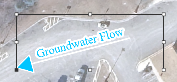

Hello!
I make groundwater contour maps frequently on GIS and one of the components I feature in my layouts is a "Groundwater Flow" arrow. I created this on my layout using an arrow and a text box on-top of it. I group them together so that they move together when needed.
Anyway, I would love to be able to save this "symbol" somehow since I am always having to recreate in every new GW contour I make.
I saved the arrow as a symbol and that has helped but I want to know if it's possible to save the entire thing!
Thanks and have a great day 🙂
BobBooth1
You should be able to put that symbol on a small layout and export the layout as an SVG. Once you have an SVG symbol, you should be able to add it to a style in ArcGIS Pro, and then you can use it when you like from there.
