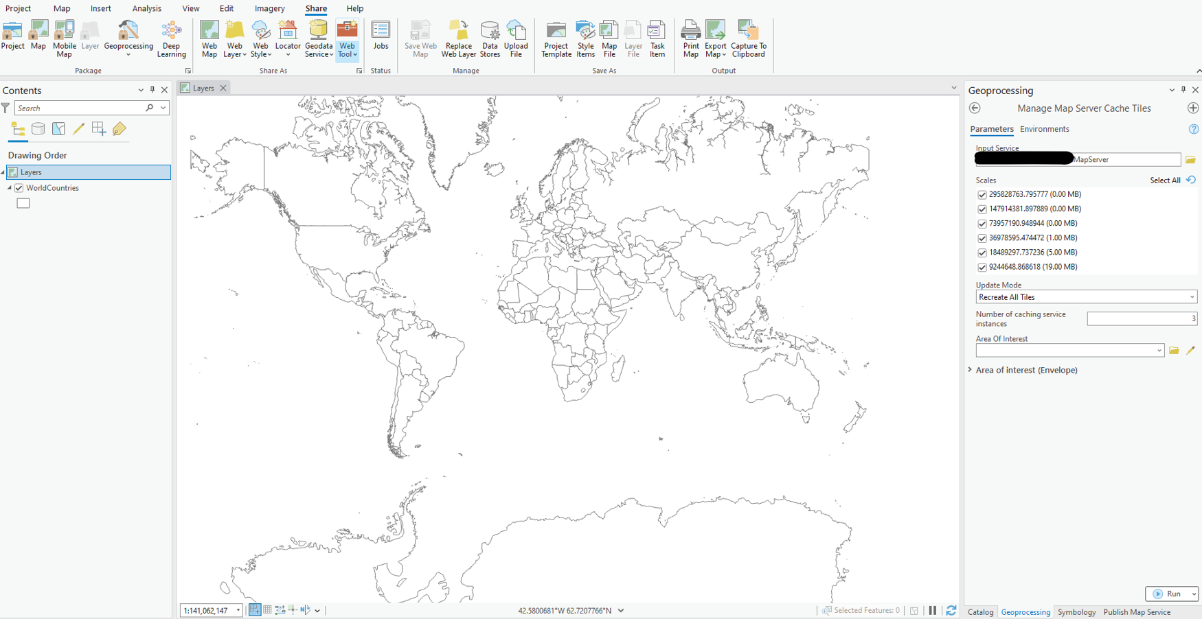

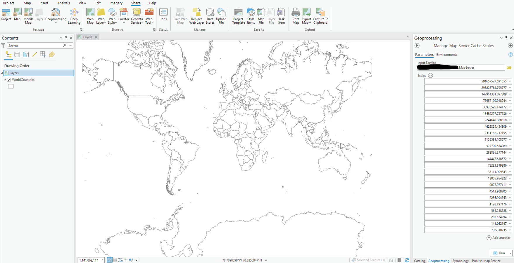

I'm running ArcGIS Pro 3.3.1 and ArcGIS Server 11.5. I've published a map image service and I'm trying to generate a cache. I've run the Generate  Map Server Cache Tiling Scheme tool to set up the cache properties (zoom LOD scales, etc.). I chose 24 LODs within that tool. I can run the Manage Map Server Cache Scales tool to verify that the service is expecting all 24 LODS. I've run the Create Map Server Cache tool to build the folder structure and configuration files for the cache. However, when I run the Manage Map Server Cache Tiles tool to do the actual cache processing, it only shows me 6 available LODs to chose from at which the tiles will be generated (see screen shots below).  I've tried all sorts of ways to get it to function properly, but nothing works. A few years ago I would do the same thing in ArcGIS Desktop and it worked just fine.  Any help would be much appreciated.

This should allow me to then run the "Manage Map Server Cache Tiles" tool, and choose which LODs I want to process.  At least that's how it always was a few years ago. However, when I open the tool and point to my service, by default it only shows me the first 6 LODs that are available to cache.
I found a work around, however I don't think it should be this way. If I go into ArcGIS Server Manager and navigate to the cache properties, I see those same LODs listed in the "Resampling" section.
If I modify them to be the top and bottom LODs that were defined in my Tiling Scheme File,
...and then run the Manage Map Server Cache Tiles tool again, I see all the LODs are available to process.
