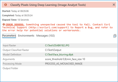

I am trying to "face blur" some images but no matter which images I choose the result is "ERROR 999999".
This has been working until updating to ArcGIS Pro 2.9. Any ideas what could have happened?

try a different raster output name and shorten the path eg. c:\Temp\blurr.tiff
just to rule out location and file type issues

Hi Dan.
Same results I'm afraid

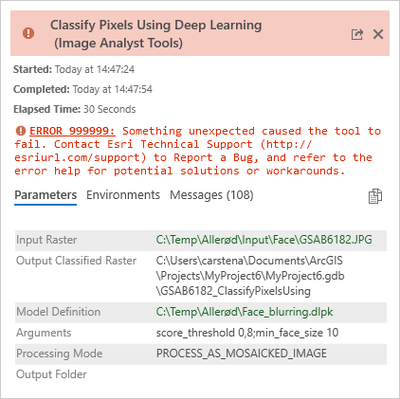

you need a file extension otherwise it is trying to create an esri grid, try
c:\Test\Output.tif

CarstenAndersson
Hi Dan.
Unfortunately the same result

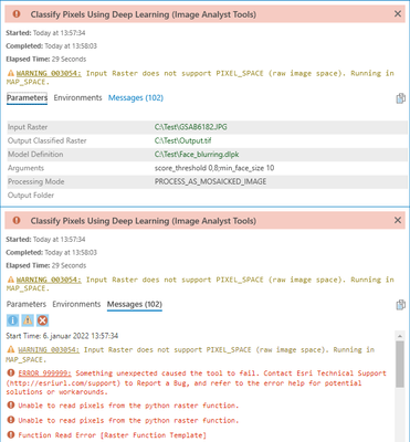

ChelseaRozek
MVP Regular Contributor
I just ran into some issues with the deep learning tools in 2.9 too. What is the text provided under Messages? It provided a clearer error for me there and I found a solution on the github page: Issues · Esri/deep-learning-frameworks (github.com)

The first messages after running the tool were:
WARNING 003054: Input Raster does not support PIXEL_SPACE (raw image space). Running in MAP_SPACE.
ERROR 999999: Something unexpected caused the tool to fail. Contact Esri Technical Support (http://esriurl.com/support) to Report a Bug, and refer to the error help for potential solutions or workarounds.
Unable to read pixels from the python raster function.
Function Read Error [Raster Function Template]
The warning at the top also showed up when this was working, so I don't think this is the cause of the error. I've tried to Google "Unable to read pixels from the python raster function" but without any luck.
DanPatterson
MVP Esteemed Contributor
If the process doesn't work with any image, then something is fundamentally wrong, so I would contact tech support.
I assume that you have the latest packages installed for deep learning

CarstenAndersson
I do have the latest packages installed. But I guess, as you suggest, that some other bigger issue is causing this. Thanks! 🙂
