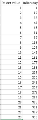

This makes sense! However, in my case, the Julian day begins at 1, not 0. Here's a chart of the conversion; would this mean the subtraction is not necessary?

Just add 1 at the end of the expression (outside all brackets). Updated my last expression.

To clarify, do you mean like this?
16*((Con(("RASTER" - (RoundDown("RASTER"))== 0.5),RoundUp("RASTER"),RoundUp("RASTER" - 0.5)))-1)+1
JayantaPoddar
MVP Alum
Yes.
