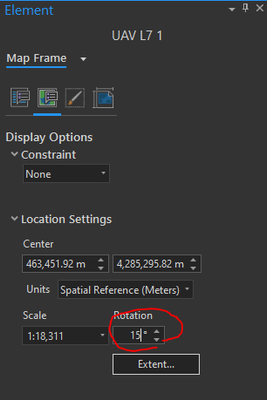

I'm encountering an issue with bookmarks for map frames with rotation.
From what I can tell, if I apply a rotation to the contents of a map frame in a layout, then create a bookmark of the extent, later applying that bookmark does not restore the extent to the original view. Instead, the bookmark restores a more zoomed-in view of the data. Updating the bookmark doesn't fix this issue.
This issue only happens to me in map frames that have a rotation applied in the frame properties.
Is there something wrong with what I'm doing? Or is this a bug?
For clarity, by rotating data, I mean right clicking the map frame in layout view, going to properties, then applying a rotation here:
My data and the map frame are all in UTM 34N projected coordinates.
