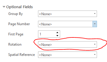

Hi,
Is there a way to rotate the map frame on a page without affecting the other pages in a map series? All pages are derived from a single map. Even if I create bookmarks, they still will affect the other pages.
Thank you for answering my question in advance.
-Riker900
Tags (1)
RobertBorchert
Honored Contributor
Create a rotation attribute in the table from which your map series is based.   Short integer.  I would suggest setting the default to 0
Then open your map series dialog in the Optional Fields select Rotation and choose your attribute field from the drop down.
