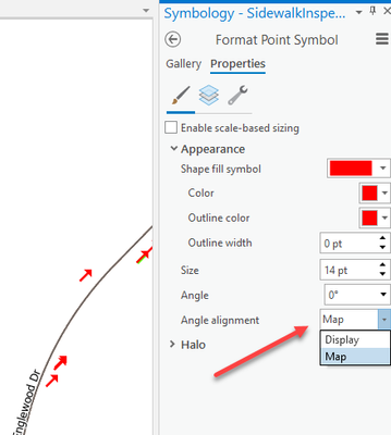

Format symbol:
R_

Like I said, this is known, but how for all symbol.  With hundred of them, on shot fit all is the way, like in arcmap.

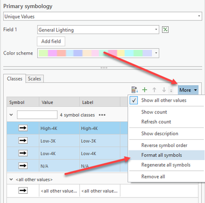

You can rotate ALL the symbols in a layer at once, but not sure if it is possible to do it for all layers as well.
To rotate all in a layer with the Map:
R_
