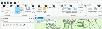

A bit late, but i just wanted to explain how KeyTips (defined in your add-in's config.daml) can be used in ArcGIS Pro.  For the screenshots in my illustration below i used the "RibbonControls" community sample:
arcgis-pro-sdk-community-samples/Framework/RibbonControls at 6078006a3943364f2a7931b19d1eb03c8a99e1c...
In order to use KeyTips in ArcGIS Pro (after you opened a project) you must first press the Alt key or the F10 key, this shows all available KeyTip letters for tabs on the Pro ribbon:
Next you press any of displayed KeyTips letters (white and framed in black). So for example to get to the “Sample Tab” I simply press the ‘X’ key. Now the UI is updated to show the ‘Sample Tab’s’ Key Tips:

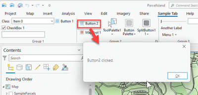

Finally, I can choose a KeyTip from the selected ‘Sample Tab’ tab. For example, if I want to execute the ‘Button 2’ command on the ‘Sample Tab’, I simply press the ‘X’ key followed by the ‘E’ key. The command is executed, and I get this:
